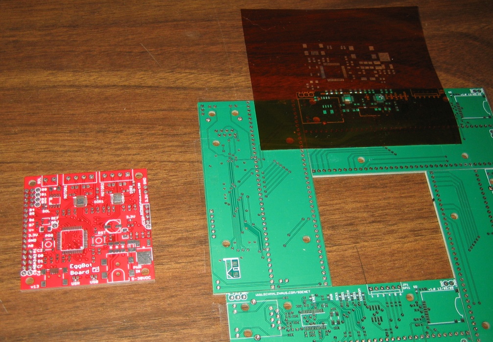

This first one shows a board ready to be stenciled. The kaptop stencil is flipped up. I just put the board in the hole (made with old boards), flip the stencil over, and squeegee on the solder paste.

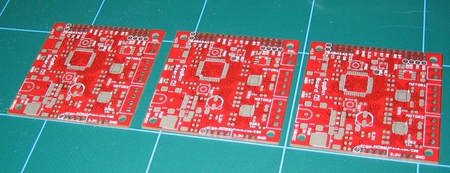

Here you can see three boards with solder paste on them ready for parts.

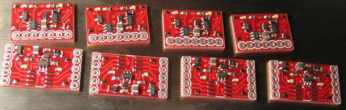

And here are some of the other boards we made that night, showing the nice joints from the reflow process.
