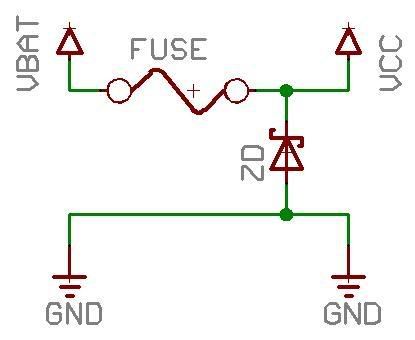

smdFan wrote:Suppose a user by mistake put a battery in reverse in the battery holder of your circuit. Can your circuit be damaged? If yes, how to protect your circuit against such mishaps.
A power diode is series with the positive lead will block
accidental reverse connections. However, a silicon diode
drops a half volt or so, and wastes power.
A power diode in parallel with the supply (cathode of
diode to positive supply) will "short out" the supply
and protect the circuit from reverse polarity. No power
is wasted or voltage dropped for correct connections.
A zener diode in parallel with the supply will protect
the circuit from both reverse polarity connection and
over-voltage. The zener voltage should be slightly higher
than the worst case normal supply voltage.
If the circuit draws a high current, or the suppply is
capable of high currents, a fuse should be included
before the diode.

By Andrew02E
#50574
before the diode.
IMHO that setup is a great balance of simplicity and effectiveness.

By riden
#50582
before the diode.
I don't disagree, but know that on an over voltage condition, you will almost certainly need to replace the zener since it will be toasted. Leon's suggestion of a resettable fuse is a good one as well, especially given the current requirements for the examples (i.e., okay for lower current, not quite so good for high currents).
