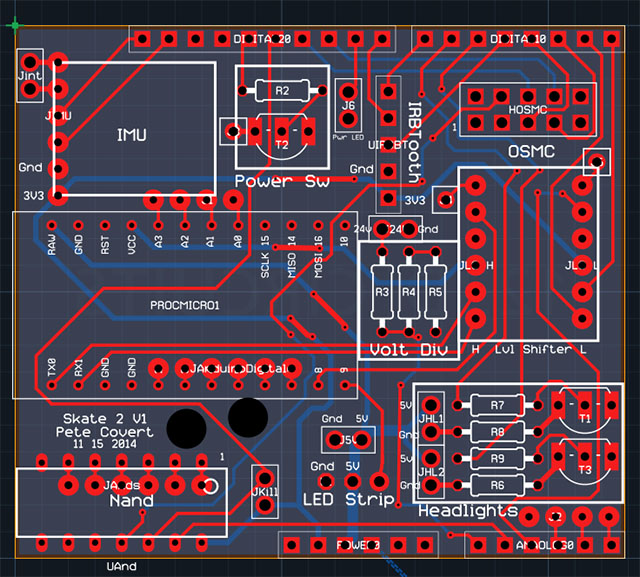

Circuit Design
Post by satacoy » Wed Nov 19, 2014 9:01 pm
Progress continues. I've refined the software a bit, and have the battery indicator, angle display, and a few other aspects of system working.
This weekend I drew up the plans for the circuit board/shield, and have shipped it off to be manufactured. It's much more ambitious than my simple shield for the first skateboard. I was in a bit of a hurry, so hopefully there are no fatal mistakes.
It'll take a few weeks to show up. In the meantime, I'm hoping to flesh out the rest of the software and get the last few mechanic changes in place. I still need to mount the Netduino, figure out where to place the BlueTooth module so that I can get reception, secure the wiring to the frame, etc.

The shield is available here:
http://123d.circuits.io/circuits/236244 ... two-shield
I can release the software once it's complete.

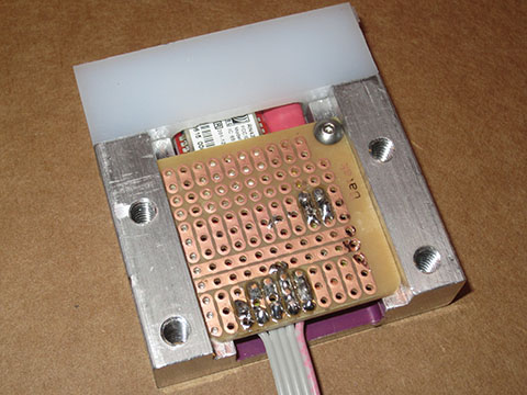

The holidays, the flu, and other projects have consumed a few months. I'm finally making some progress again on the skateboard, although there have been a few setbacks too.
First, I built a external sensor pod for the Bluetooth module and IR receiver. Testing a few plastics I had laying around, UHMW seemed to allow both Bluetooth and IR signals through. The plan is to mount this module externally on the frame, location to be determined.
Image Image Image
