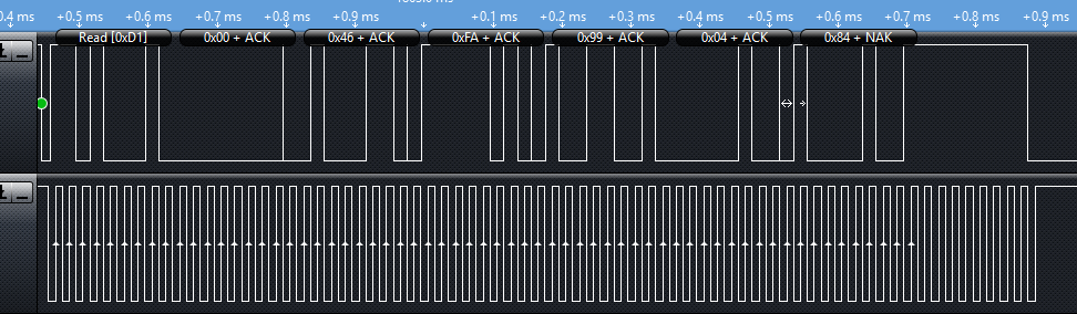

I’m trying to setup communication between an STM32F103RET6 and a MPU-9150 over I2C. After some tweaking I have got the write request to work but I have problem with read requests. I can see on the logic analyzer that it clock out 8 extra clock cycles, don’t set the stop signal and leave SDA low. In the sequence below I try to read 6 bytes and then stop.
This is my first I2C project so I’m not sure what to look for. Anyone recognizing this behavior and can give some ideas about possible errors to look for?
My program looks something like this:

UhClem, thank you very much, that was exactly the problem. I just moved the stop enable call before the last I2C_read_nack() and now the read request works as they should too.
