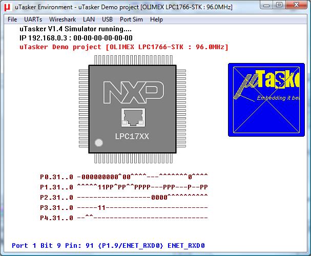

By mjbcswitzerland
#95296
Hi
Take a look at:
http://www.utasker.com/forum/index.php?topic=828.0
Here I took the Olimex LPC1766-STK (this has a Nokia color LCD, micro SD card socket etc. and not over-expensive).
It is very easy to move LPC2XXX projects to it (peripherals are highly compatible) - there is demo code there which runs the board as web server, displays stuff on the LCD and also serves web pages (long file name support etc.) from an SD card (as well as allowing data to be copied to it via FTP or managed via a DOS-like interface via TELNET or a UART).
The complete project is available as Beta version - including an LPC17XX simulator which allows all the above to be run in real-time on a PC without any hardware (also the SD card is simulated as explained in the user's guide below). Screen shot below.
